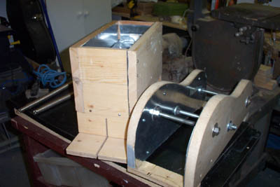

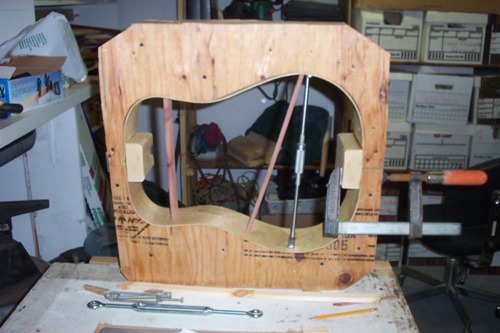

Charlie, no problem at all using it for bending forms and outside molds. Once you put screws in it for an outside mold, it will be all right and for the bending molds, both sides have to be apart from each other, let's say 6" for instance, you could always use threaded rods, nuts and bolts to keep them apart, just like here
Bending form
Outside mold
And as Al said, save the bits and strips for the rest.
